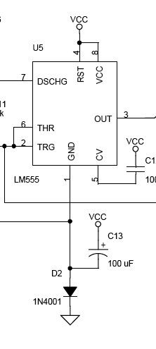

soggybag
Re: 555 timer still ticking
« Reply #6 on: July 02, 2009, 01:49:15 PM »
try this:
The whole circuit doesn't concern you just the parts from pin 1 to ground. The 1n4001 and the 100uf cap.
