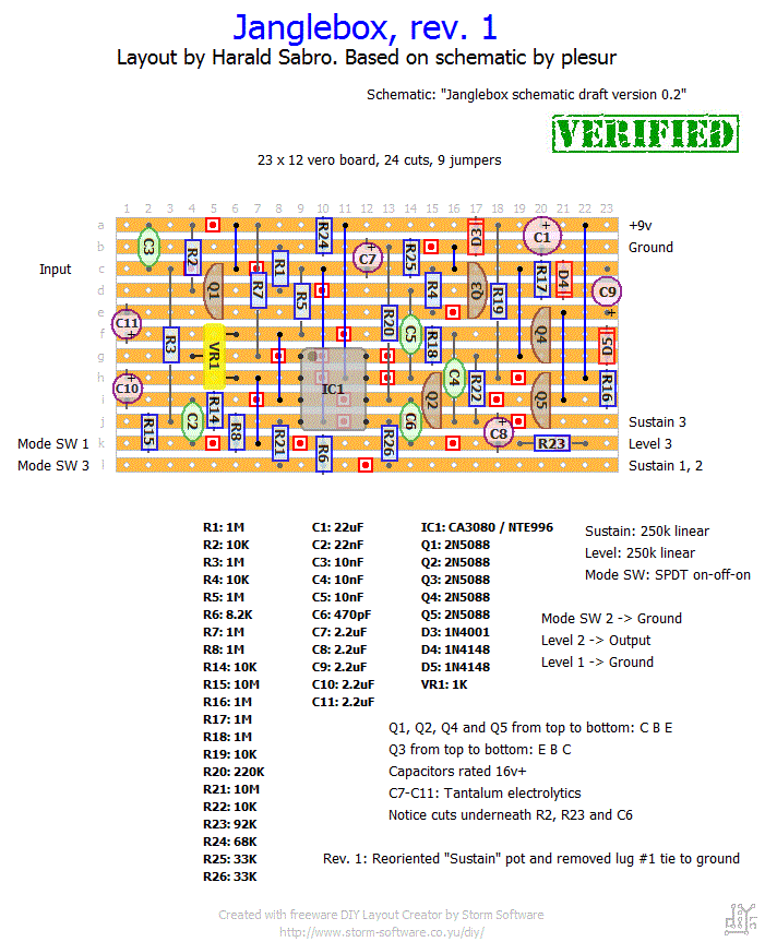

So i had this idea of building a dynacomp like compressor but adding in a tone and clean blend controls. I'd make the tone circuit switchable so i could take it out of the signal path all together if i wanted.
I've found schematics for the general dynacomp and for the tone and blend circuits i'd build, but the only thing is where to put them in the overall circuit. They need to go inbetween the sustain and level controls of the dynacomp circuit, but the trouble is i'm not sure where the sustain control ends and the level control begins. If i knew this i could easily place the tone and blend circuits before the level control.
Here is a wiring diagram of the dynacomp and a schematic. If anyone can tell me where to put my added circuits that would be amazing!

guitylerham
I am going to do the same thing as you!
I want to use the second TC in this link (the one he suggests best for compressors):
http://www.muzique.com/lab/swtc.htm
and put it in the design for the DynaComp with Jangle Switch and Blend Knob here:
http://www.aronnelson.com/gallery/main.php/v/ibodog/other/dynacomp+with+clean+blend+vero+verified+v1_1.gif.html
From what I can tell, you can just put the TC in line with C23 and the Volume Pot. Does this make sense? I've yet to build and verify these mods together.

bsmcc2010
thanks guitylerham.
so are the red squares on this board where you cut the hole out? and is it just a plain pcb with holes punched in it?
Also, i can't seem to see a switch on there? i'd want a 3pdt switch with LED
its vero board/strip board...its copper clad in strips with holes drilled already, red markers are for the cuts ..
you will be able to add a 3pdt with led too ok...... ;)
bsmcc2010
Thats really annoying...that was by far the best and easiest schematic/wiring diagram i'd found. All i needed to do was add the tone control and the 3pdt switch into it, which isn't hard! :(
bsmcc2010
that's not it  :-\
that looks like just a jangle box to me
bsmcc2010
i think it's been deleted from the site  :-[
bsmcc2010
still can't seem to find the diagram that guitylerham linked us to anymore :/ why help?
alfafalfa
bsmcc2010
That's exactly the on! only that is the un-verified version...looks the same to me though
thanks!
bsmcc2010
ah man, just realised that that's not the same as the verified one...which music mean that it doesn't work? :S
