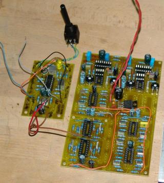

STM - surely if one half of SAD1024 has fixed delay, it will need a separate clock from the modulated clock used in the other half, and I'd wager $10 worth of pirate CDs from Quito that would introduce some fairly quaint noise to the equation.

I agree that if you build a dual-clock dual-BBD circuit on a protoboard, perfoard or single-sided PCB you will have all sorts of intermodulations, birdies and artifacts for sure.
On the other hand, if you use a double sided PCB, with one side devoted to the ground plane, keep separate analog and digital grounds just joined at a single point, use tantalum plus ceramic decoupling capacitors on the supply pins of each and every IC, filter independently both BBD's outputs, and do a careful signal layout (i.e. avoid running clocks near audio lines), my feeling is that IT SHOULD WORK PROPERLY.
I don't think its impossible. It's just harder to do (IMHO).
 :roll: Mmmhhh. this sounds like a challenge to me: "bust the don't use two unsynchronized BBD's myth"  :wink:
I have experience with high frequency digital and analog electronics, as well as microstrip and RF PCB design techniques. My former job was for a solid-state AM/MW transmitter manufacturing company, where I participated in the design of a 100 kW transmitter (currently on-air in Belo Horizonte, Brazil).

puretube
Schematic of 0.5 msec Analog Delay for Through-Zero Flanging
« Reply #51 on: September 20, 2004, 03:18:02 PM »
absolutely correct!
(I`m quite sure you can do it.... :wink: )
iirc, I posted a pic of my approach a few months ago...?...

puretube
« Reply #55 on: September 20, 2004, 05:31:40 PM »
Quote from: puretube
before: (with "birdies")
after:
