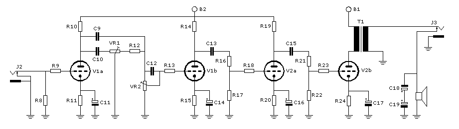

I was wondering.. If I were to swap out my 6112 preamp tube for another 6021 could I rehash it to be single ended and use the first triode of the power tube as a preamp section for more gain? I got the idea looking at this schematic...
If so, it seems like I would need a different output xfmr. Or could I use the 125a I have and omit the B+ tap?

There is a difference between se and pp transformers and i dont know if it would be fatal to the ot .Air gap and standing dc are terms i see a lot but dont understand so i wont pretend to. However.... if you went se and did the proposed plan you would get about half the volume your getting now as you will be missing half a tube. I would just put a boost in front because they are cheap and fun to build lol. A tube boost is even more fun. just pay attention to cap sizes and low pass/ high pass filters etc. Let your conscience be your guide. if your power supply is heating up and dropping volts i would hesitate to load it up any further.
