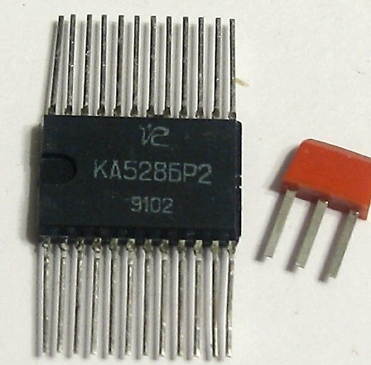

I have a whole bunch of these...
They are KA528БР2 (KA528BR2). Russian equivalents (supposedly) to the SAD1024, but with worse signal to noise figures than the 1024. Not really sure how that would impact the overall performance, but if someone can help me with the pin to pin translation, I would be ready to push this into service here.
Here is the datasheet (in Russian); https://www.promelec.ru/pdf/528br2.pdf

Scruffie
I've read they're more like MN3001 which is a very big distinction and would be far worse than an MN3007 in this application.
We'd need to know its insertion loss if any, it's gain vs. freq, it's clock pin capacitance, P or N channel, if the output voltage varies with frequency and if it needs gate biasing.
I can take some guesses from the graphs in those folders as to what's what and if they're right, while not bad in areas, it's not really the best suited for this job. Headroom looks more like a 320X series chip, gain vs. freq looks pretty good, don't see any gate biasing in the application, insertion loss is 5dB (which would be what makes it more like the MN3001 and is the real killer) and I think its saying it'll run from 20kHz - 1MHz so I assume the clock pin capacitance isn't too high. It would however, be perfect for a Tychobrahe Pedal Flanger clone...
