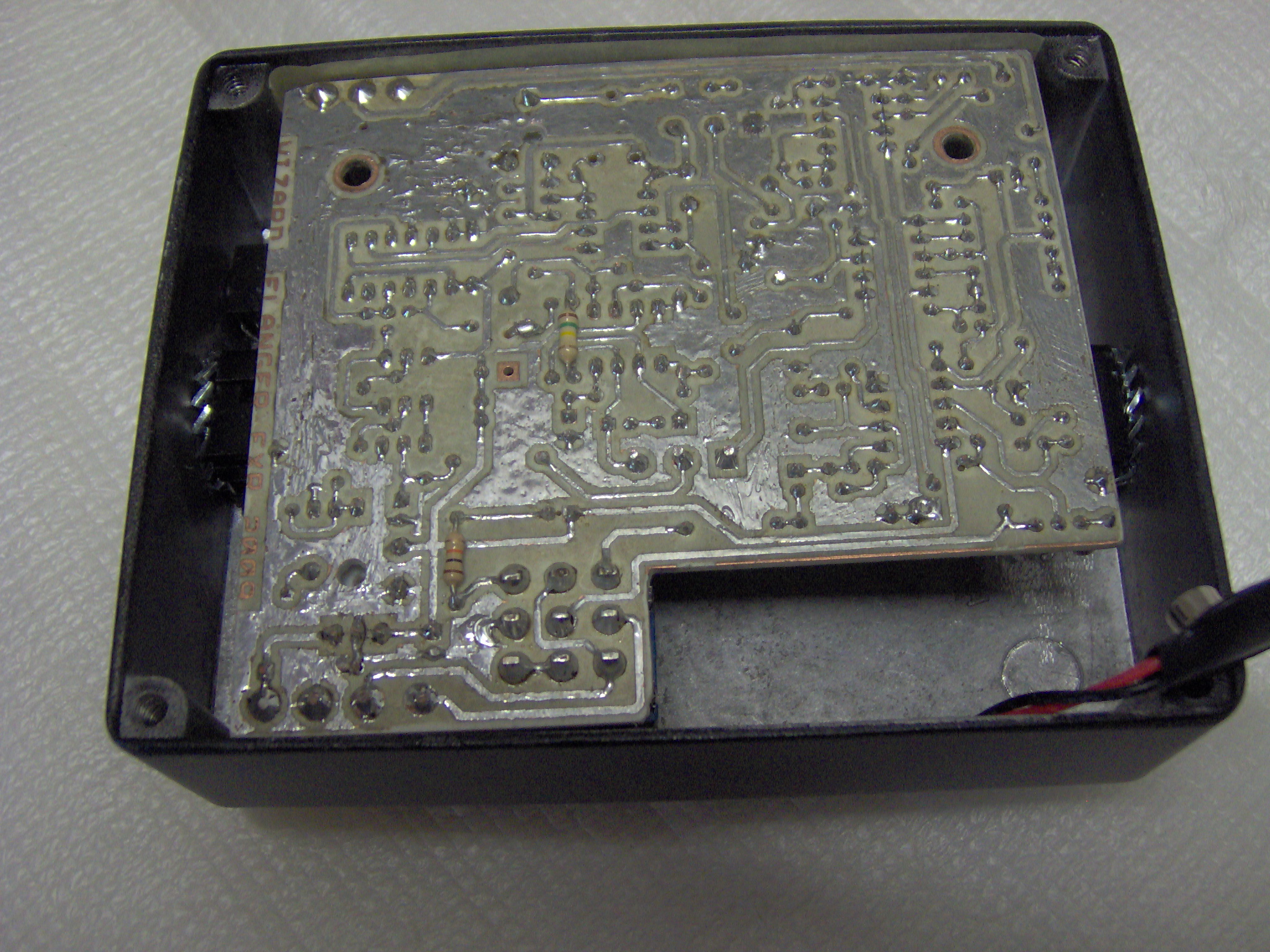

I have no more the etching PCB files 'cause the prototype pictured here http://www.diystompboxes.com/smfforum/index.php?topic=36392.msg655757#msg655757 was just that: a prototype,
I started modding and tweaking it as soon as I built it, so I redrawn pratically everything. [If you look carefully at the comp. picture you'll see there are pads for other parts not used (according to schematic), but since I was etching the board and I had to sell the pedal I wouldn't have any concern in case of missing components or misbiasing (I didn't breadborded it at the time, I did it few months ago, testing with different LFOs and dual BBDs)]. I build other units with other tweaks (such as a 3 transistors control for 4013 and just 2 knobs or a 4046 clock gen.), but all PCBs "on the fly".
There's a picture here http://www.diystompboxes.com/smfforum/index.php?topic=79154.msg652910#msg652910 of the schematic and comp. layout,
here you can find guts picture, you may trace it down eventually
