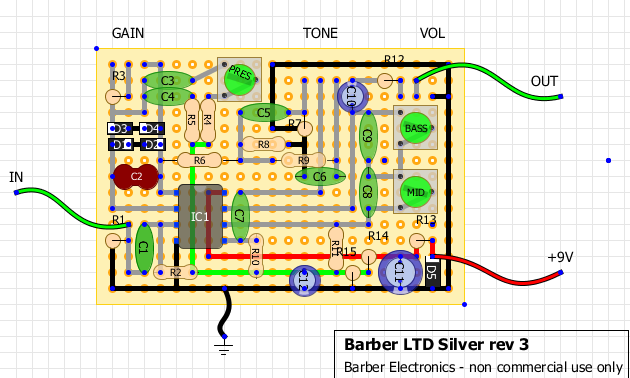

The image in the last post has been updated, I had the wrong orientation for one of my electrolytics.
I built it, but it's quite quiet, and the drive knob doesn't do anything - it's like max drive all the time.  Does the latter problem ring any bells to anyone?

Sounds like you may have accidentally built the Zakk Wylde version...

Ok I found a small but significant bug in that layout... here's the updated version.  Which WORKS!  :icon_mrgreen:
I don't know how to edit the last one, so I may have to just delete the source image... I'll leave it up for the moment so others can learn from my mistake.

Here's the most recent PCB version I did...in case anyone needs it:
Silverfox ver.3

Heh I'm almost glad I didn't see this until now.  That would have killed me to have a huge revision just as I was debugging the last one.
I replaced the 150k tone resistor with a 47k and the tone control is very nice now.  I couldn't hear the 150k at all for some reason.
The only issue I'm having now is squealing/oscillation when the output is turned up to about 3:00 (way past unity).  Otherwise, this is a SUPERB overdrive!
