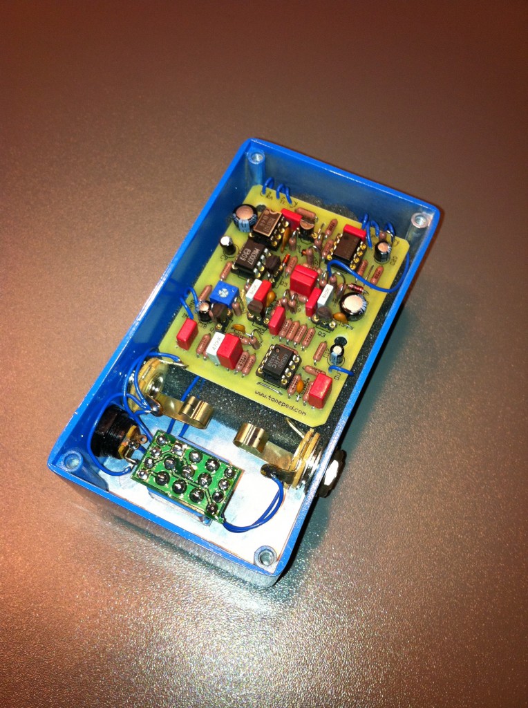

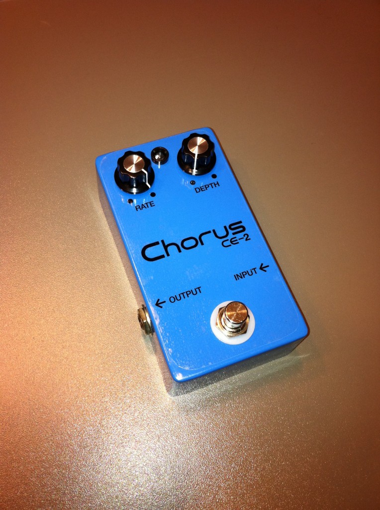

The first one is a CE-2 Chorus clone built on a Tonepad board in a 125B. The board took forever to populate and solder, but it worked perfectly on the first try and sounds great. I didn't do any part subs, but I'm going to try some different opamps out when I get a chance.

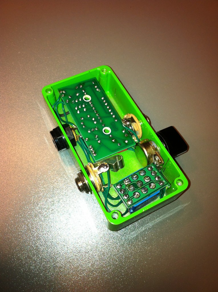

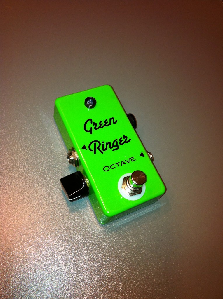

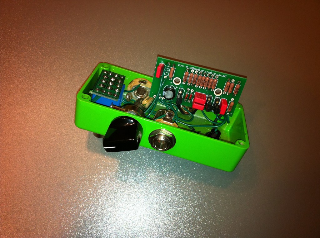

The second one is a Green Ringer clone built on a General Guitar Gadgets board in a 1590G. I screwed up the layout and put the input and output jacks across from each other not realizing that there wasn't enough room. I drilled another hole a little farther up and wound up using the old hole for a volume pot since the pedal can be kind of loud with certain amps. The 1590G is nice and small, but kind of difficult to do a layout for due to it being so shallow.
Tonepad CE-2 Clone
GGG Green Ringer Clone in a 1590G

blooze_man
What the knob in the green ringer do?
Big Muff, Trotsky Drive, Little Angel, Valvecaster, Whisker Biscuit, Smash Drive, Green Ringer, Fuzz Face, Rangemaster, LPB1, Bazz Fuss/Buzz Box, Radioshack Fuzz, Blue Box, Fuzzrite, Tonepad Wah, EH Pulsar, NPN Tonebender, Torn's Peaker...
aflynt
QuoteWhat the knob in the green ringer do?
It's an output volume control. Just replaced the output resistor with a 50K pot wired as a variable resistor. I found that with certain amps the effect can really cut your head off. This lets me tame things down a bit.
